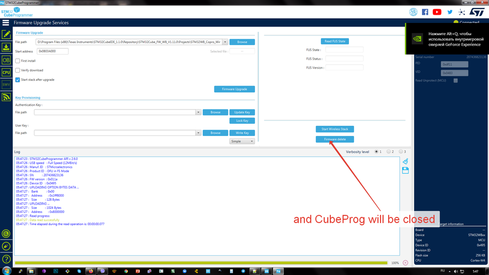

I use it to program (upgrade FUS, stack) my stm32WB55 on MB1293C board and sometimes when I push buttons CubeProg is closing.

I also recomend make text more userful
1) "Firmware delete" - what should do this button? Delete firmware on MCU1, MCU2, both, or delete FUS? May be it should calls "Radio stack delete"?

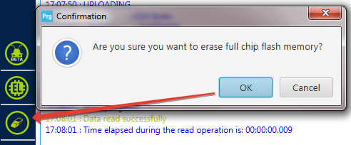

4) What means "full chip erase" button in case of stm32wb55? Erase MCU1, MCU2, FUS, all? In CubeProg 2.6 this button just fail:
01:04:01 : MASS ERASE ...
01:04:01 : Error: Mass erase operation failed.Please verify flash protection
01:04:01 : Warning: Connection to device 0x495 is lost
01:04:02 : Disconnected from device.

2021-04-05 1:52 PM
Well, You are lucky, I can't close mine.
2021-04-06 9:22 AM
Hi @LMI2 ,
Do you mean that by pressing the Firmware delete button, STM32CubeProgrammer crashes and could not be closed anymore ? did I will understand your problem?
Also, could you please precise which board are you using as well as the STM32CubeProgrammer version you're working with.
Your feedback will be very important to track the root cause of any misbehavior.
Khouloud.
2021-04-08 6:15 AM
New 2.7.0 looks more stable. I am testing it.

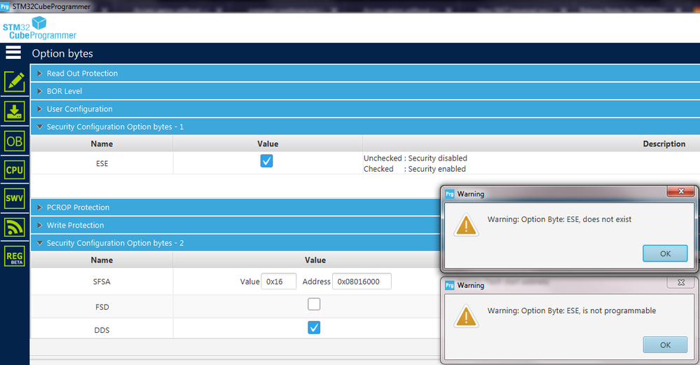

There is not good fix for ESE in st-link mode. In 2.6 it was wrong "doesn't exist", but now it is "doesn't exist" and "is not programmable". Please look at my prev post https://community.st.com/s/question/0D53W00000dP06wSAC/stm32cubeprog-wb55-gui "full chip erase" button now works! But I think message "Are you sure you want to erase full chip flash memory?" is not good in case of stm32wb55. What means "full chip erase" in case of stm32wb55? Erase MCU1, MCU2, FUS, all? So you should use message like "Are you sure you want to erase MCU1 flash memory?" And what about English? I am not English speaker, but may be "Are you sure to erase" is better than "Are you sure you want to erase"?

2021-05-01 3:53 PM
I updated the CubeProgrammer and tested my board today, and I did not find any problems.
