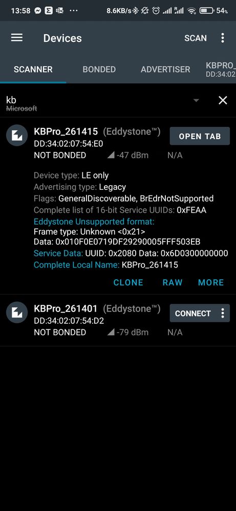

2022-05-11 3:24 AM
Yes, it is a Bluetooth sensor it advertises data like a beacon it's connectable so that the user can configure it (time of advertisment, data type ...)
this is his scanned data:
[BLE] MAC : [DD]:[34]:[02]:[07]:[54]:[E0] RSSI= -89
[BLE] ADV_FRAME= 2 1 6 3 3 aa fe 12 16 aa fe 21 1 f e 7 1a d 29 e 0 5 ff f2 3 f3 a7 5d 93 6e
[BLE] Frame_Type= 0x21 : Kbeacon
[BLE] Vbatt = 3591mV Temp = 26.5 C Hum = 41.5% X:5;Y:-14;Z:1011

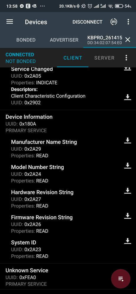

2022-05-11 5:02 AM
There it is, it is connected like any other device and i can manipulate it's configurations
