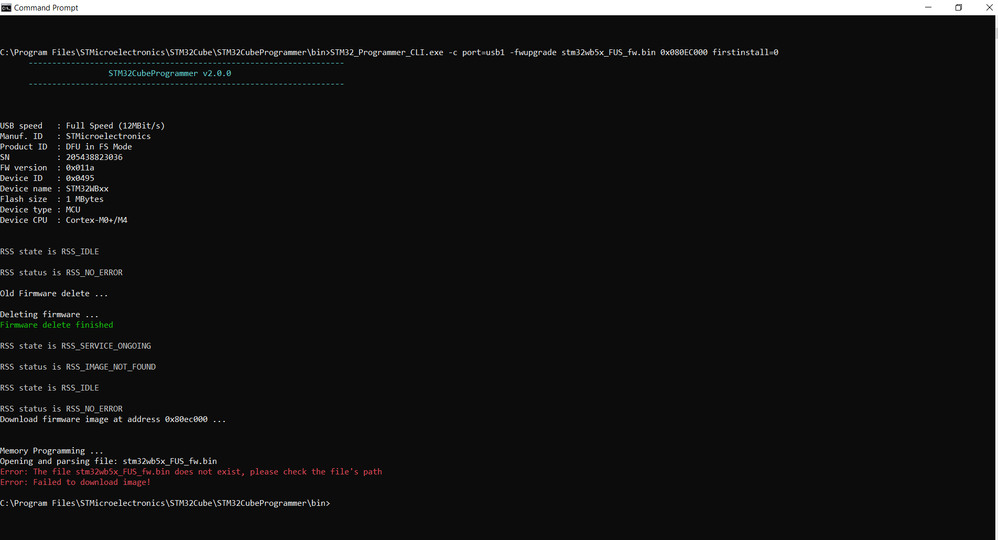

Hi. I am trying to update my board using STM32WB Copro Wireless Binaries. But, I am getting following error:
I cannot download the image.
Can you please help me with this issue? I can flash the board but cannot use bluetooth functionality.

Your upgrade fails because the FUS binary can't be found. Maybe you could try to change the parameter for file path to something like: "c:\myfolder\stm32wb5x_FUS_fw.bin"
Regards Adrian

Thanks Adrian. It worked. I was under the impression that upgrade command will download this file over the air.
To all community members, these binary files are listed here: https://github.com/STMicroelectronics/STM32CubeWB/tree/master/Projects/STM32WB_Copro_Wireless_Binaries

I think for the 1 MB device the address given in the command line should ve 0x080cc000.
