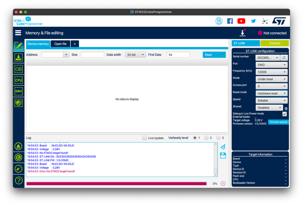

Before this I'm launching my modified version of LoRaWAN_End_Node firmware, but my Nucleo Board keeps restarting and heating up so I unplugged the USB cable. When I tried to connect my board back I get a FAILS.txt file with the following content
The interface firmware FAILED to reset/halt the target MCUI tried to connect my MCU to the STM32Cube Programmer with under reset configuration and trying all reset mode configuration but got no luck.
That means the on-board ST-Link can't communicate with the STM32WL55 for whatever reason.
What part exactly is heating up ?
You may have a short-circuit somewhere.
2023-03-10 7:01 AM
It is around the block that contains both the MCU and LoRa chip. Only thing that I connect to the board is only a Teseo-LIV3FL module and I'm pretty sure it is not the one that caused any short-circuit since I've been using them for long time and got no problem. The heating issue is came after I tried to use the LoRa interface.
Tried on a spare board and the heating issue is gone (even with the LoRa interface turned on). I suspect the LoRa chip was defective since the heating issue only happening if the LoRa interface is turned on.
