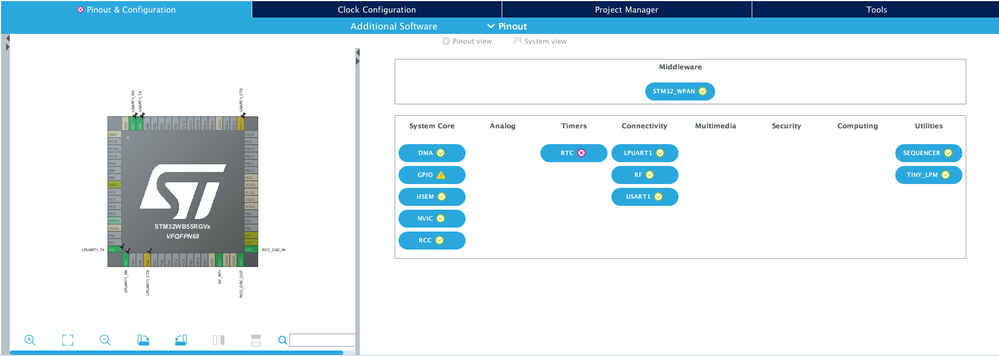

I'm having the same issue. By mistake I have overwritten the demo on the nucleo board and I want to use the BLE_p2pServer example to have again the demo.
When I open the BLE_p2pServer I cannot even build it. There is an issue in the pinout configuration as you can see below:
I have tried resetting the RTC configuration to get rid of the (X), however I'm still not able to build it.
Did you manage to import correctly that project and run it on the nucleo board?
