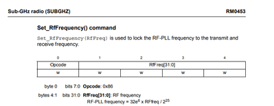

I'm working on an application that uses the NUCLEO-WL55JC development board. I was looking in the SubGHz_Phy_PingPong example code, and I noticed a macro called SX_FREQ_TO_CHANNEL. To use this macro, it seems you input the carrier wave frequency you want to transmit at, and it converts it to the value you pass as an array of 8-bit numbers to HAL_SUBGHZ_ExecSetCmd(&hsubghz, RADIO_SET_RFFREQUENCY, array, arr_len).
So if I want to transmit at 868 MHz, I give that value to SX_FREQ_TO_CHANNEL, which outputs 910,163,968. But why is SX_FREQ_TO_CHANNEL needed at all? Why can't I pass 868,000,000 directly in the RADIO_SET_RFFREQUENCY packet?
I think it has something to do with the RF-PLL frequency, but I don't understand. Can someone help explain why RADIO_SET_RFFREQUENCY doesn't actually set RF-PLL to frequency included in the packet?

The SX_FREQ_TO_CHANNEL(chan, frequency) take the frequency (in MHZ) and calculate the RfFreq that will be addeed to the Set_RfFrequency() command:
Refer to the chapter 5 of the RM0453 for more details.

Hello @AJ_1

Let me ask my question a different way: when I want to transmit at 868 MHz, why am I calling the RADIO_SET_FREQUENCY command and giving it 910,163,968? I don't want the center frequency at 910 MHz, I want it at 868 MHz. If I called the RADIO_SET_FREQUENCY command and gave it 868,000,000, what would my center frequency be then?

Thanks for the quick reply. Okay, I understand that SX_FREQ_TO_CHANNEL performs the math so you get the correct number to pass to Set_RfFrequency(). I think at this point I'm just trying to understand how the RF-PLL works.
I have 2 follow-up questions:
1. Would you agree it's confusing to have a function called "Set_RfFrequency(Opcode, RfFreq)", where you don't give it the actual RF Frequency? Instead you pass it your desired RF frequency * 1.048576.
2. Since 910,163,968 isn't the actual frequency you transmit at, what is it? Is it a counting value? Does the microcontroller count to 910,163,968 each second and that tells it how quickly to oscillate?
