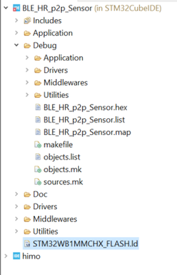

As a momentarily work around, you can reduce the _Min_Heap_Size from 0x300 to 0x299 or the _Min_Stack_Size from 0x900 to 0x899 on the STM32WB1MMCHX_FLASH.ld file of the project.
