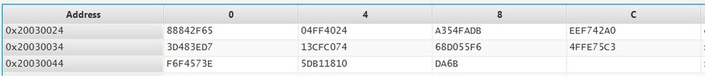

Read back DIT table shows results as follow:
0x20030024 : 88842F65 04FF4224 E344FADB EFF742A0
0x20030034 : 3D4C3EF7 13CFC074 68D055F6 6FFE65C3
0x20030044 : F674573E 5FB11850 C24ADA6B ACBB243B
0x20030054 : 4206EEED

I have IPCCDBA = 0x0000, and DIT table seems placed in a correct place:
r ap 0 @0x20030000 0x00000004 bytes Data 0x20030024

Reading DIT table I get result as follow:

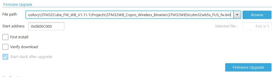

During the first try of FUS upgrade up to v1.2.0 I got en error "FUS_STATE_ERR_UNKNOWN" after the second try it shows "Firmware Upgrade Success" but FUS version still broken.
Start address is correct,

Anyhow can you try to upload the M0+ FW in the Flash memory?

Do you mean put stm32wb5x_FUS_fw.bin starting from address 0x080EC000? If yes, it didn't help.
2021-06-08 10:30 AM
No I was thinking about loading the M0+ FW
