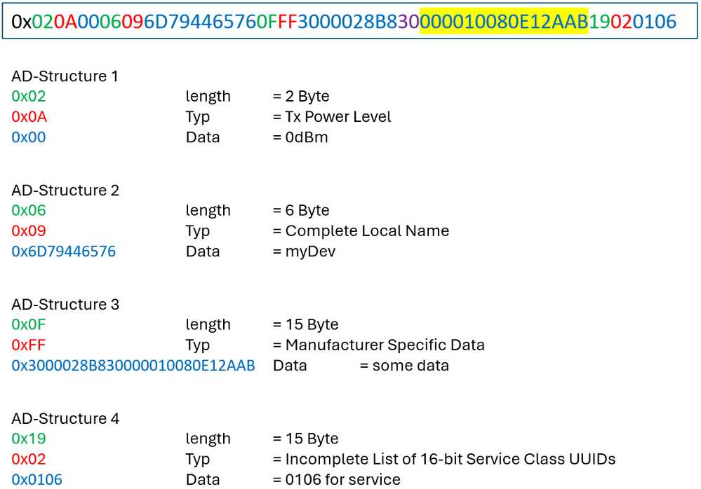

During the advertising process, I got this raw data with the BLE scanner on my phone. I mean that the 0x30 is the ID for STMicroelectronics, but what is behind it? Can someone explain to me what 000010080E12AAB is?

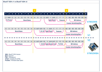

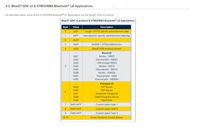

The Advertising raw data is well explained on the paragraph 4 of the STM32CubeWBA Bluetooth® LE MCU Package - stm32mcu Wiki page.
