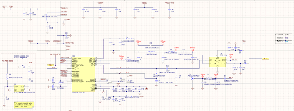

the hardware design is
https://github.com/Sosteco/generic-node-se/blob/develop/Hardware/sch/sch-stm32wl.pdf
Our design main difference is that we are using 32MHz HSE TCXO with 3.3 VDD, we modified TCXO_CTRL_VOLTAGE from TCXO_CTRL_1_7V to TCXO_CTRL_3_0V in radio_conf.h
I checked the voltages in PB0_VDD_TCXO is 0.756 V (always), it must be arround 3.0 V... and VFBSMPS is 1.945v and it must be maximum 1.62 (datasheet).
