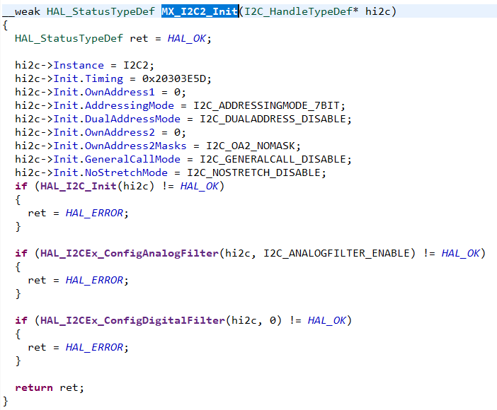

I am using the Nucelo board and communicating with an IKS02A1 trough I2C2 using PINs PA11 and PA12 with the following configuration:
I have initializaed the I2C folowing the guidelines in "stm32wlxx_hal_i2c.c", and when I use "HAL_I2C_IsDeviceReady()" function I always get BUSY_ERROR.

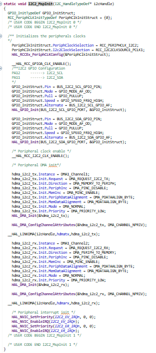

The initialization is done through:
DMA and interrups are both initialized even though I am not still usign them. I tried not initializing them them and the results are the same.
