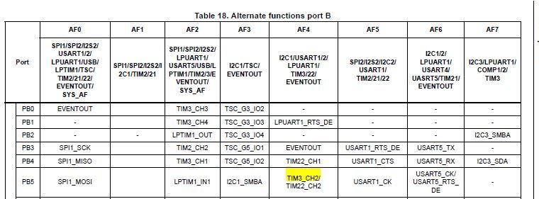

TIM3_CH2 on PB5 is AF1
2019-09-13 10:01 PM
This is given in datasheet.
