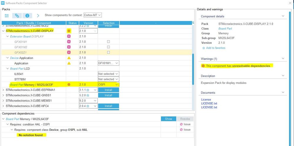

Now for the NUCLEO-H755ZI-Q, it seems that there are some compatibility issues with the X-Cube-Display and the OCTOSPI component has unresolvable dependencies. I have attached a screenshot.
0693W00000NrSI6QAN.jpgI recommend you trying another MCU or board that suits your application.

Pretty sure the H755 doesn't have OCTOSPI, and the Macronix "L" part is QUAD, so I can see that being an unbridgeable dependency, and perhaps something the tool should be wise too, and offer/show things that are workable.
