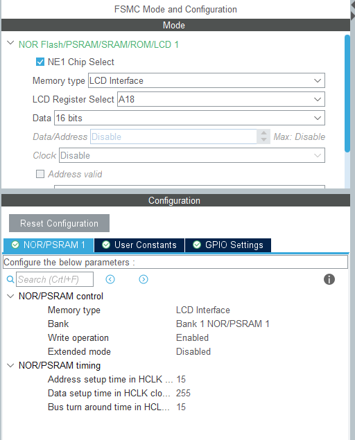

Im using: FSMC 16 bit LCD, F407VE, no-OS, ILI9341.

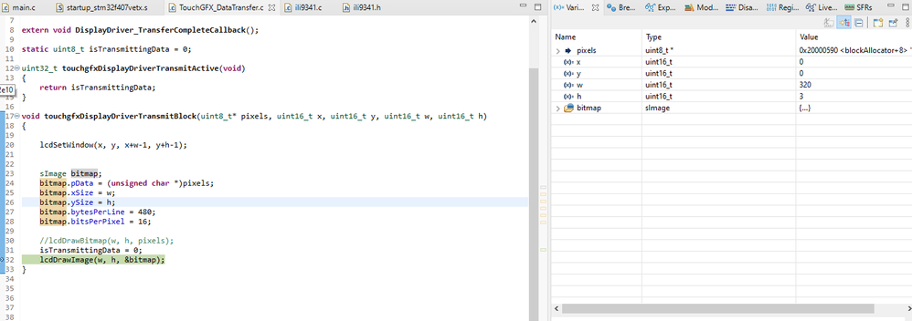

I made callback for Vsync, made TransmitBlock function.
When i starting my project, touchgfx calls once my DrawImage function with Height = 3
I have 320x240 display, and 3 rows is <10% of my display.

Problem is solved: i chose mode "partial buffer" with 3 buffers. And this 3 buffers was called.
I forgot to call callback function "DisplayDriver_TransferCompleteCallback();".
Now all screen is filling with my graphic application
