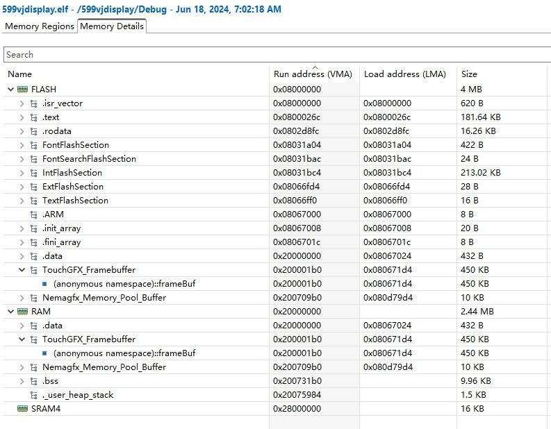

I made a touchgfx project by CubeIDE,when I choose touchgfx framebuffer by allocation,after build ,the framebuffer is placed into flash,then ram.I wonder why.

2024-06-18 7:10 AM
The framebuffer needs to be in the RAM (either internal or external). But how you did conclude that the frame buffer is located in the Flash? Which board are you using? ST or custom board? which MCU?
Need to provide more details, so TouchGFX expert(s) could help you.
2024-06-18 7:47 AM
this is the memory details form CubeIDE.

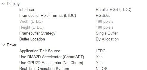

this is touchgfx settings

2024-06-20 6:34 AM - edited 2024-06-20 7:06 AM
Hi @amb ,
It seems to be located at RAM 0x2001b0 right ? I guess the issue is that it is initialized by C++ RTE. The frame buffers needs to be marked by some gcc speciofic __attribute__, hm is it 'noinit' ?
[Edit]
https://www.nongnu.org/avr-libc/user-manual/mem_sections.html
This sections is a part of the .bss section. What makes the .noinit section special is that variables which are defined as such:
will not be initialized to zero during startup as would normal .bss data.
[Edit 2]
I see file
\ST\touchgfx\framework\include\touchgfx\hal\Config.hpp
has many defines dealing with that sort of problems. It is a jungle and I run simulation so cant check with embedded toolchain.
2024-06-20 7:04 AM
I found the framebuf[] in TouchGFXGeneratedHAL.cpp file.It says this:
// Use the section "TouchGFX_Framebuffer" in the linker script to specify the placement of the buffer
LOCATION_PRAGMA_NOLOAD("TouchGFX_Framebuffer")
uint32_t frameBuf[(480 * 480 * 2 + 3) / 4] LOCATION_ATTRIBUTE_NOLOAD("TouchGFX_Framebuffer");
static uint16_t lcd_int_active_line;
static uint16_t lcd_int_porch_line;
this file is auto generated,I didnt change it.

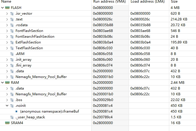

2024-06-20 7:28 AM
hello @ferro
I tried change like this:
uint32_t frameBuf[(480 * 480 * 2 + 3) / 4] __attribute__ ((section (".noinit")));
this frameBuf array is indeed only in ram now.and the program still works fine.
thanks for your advice.
2024-06-20 9:36 AM - edited 2024-06-20 9:37 AM
Hi @amb
>"frameBuf array is indeed only in ram now"
Splendid. But still, it is strange that the frameBuf with all the ornamentation
was initialised. Could you please try again the old version and see if the flashing of the FW is noticably longer compared to correct version ? To flash 0.5 MB (framebuffer initialisation) seems like a lot. Maybe other people waste lot of FLASH and time waiting to flash this as well. Might require Gfx fix; maybe add some warning or even throw a compiler error.
