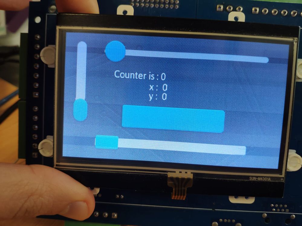

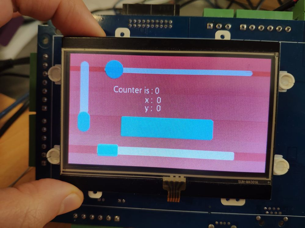

my resistive touch screen looks like this. Why I am seeing this continuous line of my horizantal sliders. There is no such a problem on vertical one. How can I fix this? Is this about screen?

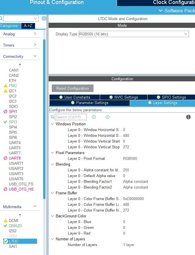

It's custom board. I just changed LTDC Gpio settings. For my system Display type is RGB565.
Maximum output speed from Low to High and problem is solved.

Sure this isn't some signal bleed issue? Or with the power?
