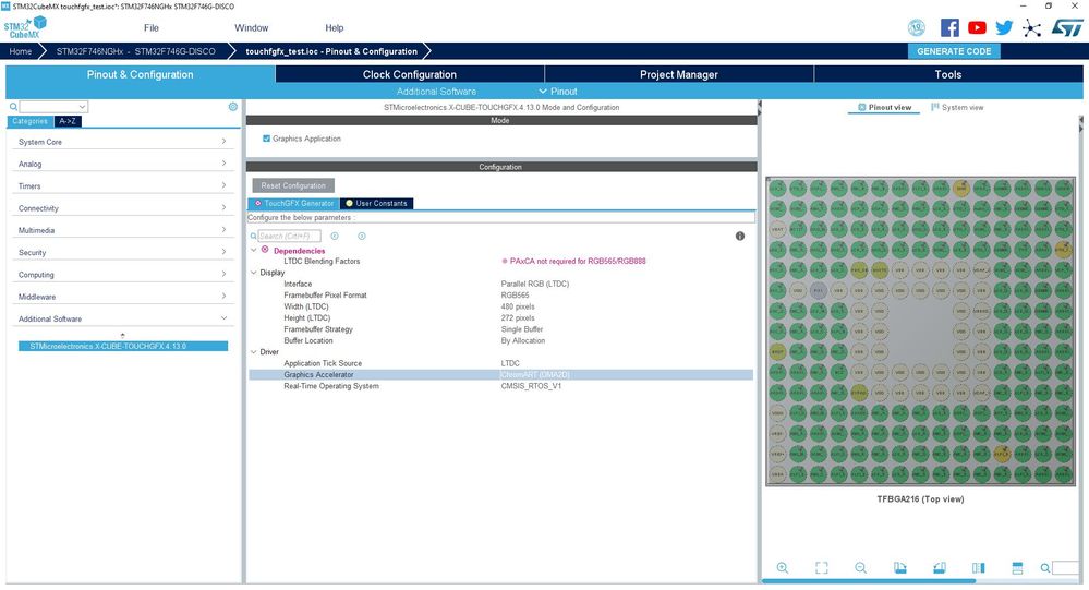

2020-01-07 6:46 PM
So this new 5.5.0 shows it is RC6 dated 12-30-2019 and the 5.5.0 that i got from ST support is dated 12-20-2019. They both show an error as shown in the image. I have tried different combinations using the drop downs but i can't get rid of the error which prevents me from generating a project. How do you start TouchGFX from CubeMX? I have both TouchGFX 4.12.3 and 4.13.0 installed. What am i doing wrong?
2020-01-08 3:58 AM
It's not an error. It's a warning to say that you do not need this particular blending factor for your LTDC layer.
