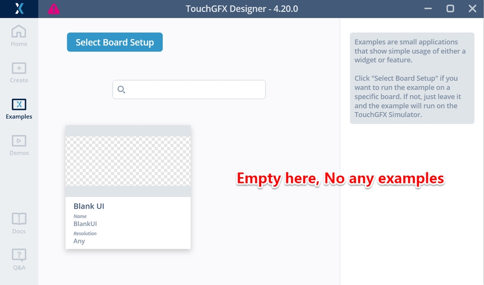

Hello @Xzhiy.1 ,
That could be related to your Windows OS version.
If you are using Windows 7 or 8, you won't be able to see demos/examples in TouchGFXDesigner 4.17.0 and more recent versions.
I strongly recommend you to always use the latest version of TouchGFXDesigner (currently 4.20.0) with Windows 10.
Hope that this helps,
/Yoann

2022-07-12 1:39 AM
2022-07-12 1:46 AM
Oh, No! No! I return back from Win11 to Win7, which is best for me.
Thank you Yoann KLEIN for your help.
2022-07-12 1:53 AM
I think it maybe relate to java , what java version TouchGFX 20.0 needs?
2022-07-12 2:02 AM
hi . i have same problem.
is it possible to download all sample without TouchGFX software?
2022-07-12 2:10 AM
You can see in the screenshot you provided, on the top left corner, that TouchGFX can't connect to internet.
Did you check your internet connection ?
If yes, please close TouchGFXDesigner, open a browser window, and open TouchGFXDesigner again.
Let me know how it's going.
/Yoann
2022-07-12 2:14 AM
Hello @Natali ,
You mean downloading Examples and Demos without using TouchGFXDesigner software ?
If yes, that's not possible.
If an older version works on your PC, you could use demos and examples on this version, and then upgrade to more recent version afterwards.
/Yoann
2022-07-12 2:30 AM
Hi, Yoann KLEIN, thank you.
Yes, I notice that I'm not connect to Internet, but my Edge can view web, I don't know why, working on it.
2022-07-12 2:51 AM
JDK 1.8 installed , but nothing help.
