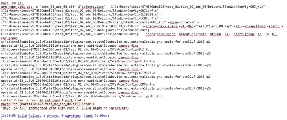

The complete error is on capture (phat_and_symbols_04.jpeg) or below
13:25:53 **** Incremental Build of configuration Debug for project test_02_adc_00 ****
make -j4 all
arm-none-eabi-gcc -o "test_02_adc_00.elf" @"objects.list" -l"C:/Users/leoab/STM32CubeIDE/test_02/test_02_adc_00/Drivers/STemWin/Config/GUI_X.c" -l"C:/Users/leoab/STM32CubeIDE/test_02/test_02_adc_00/Drivers/STemWin/Config/GUIConf.c" -l"C:/Users/leoab/STM32CubeIDE/test_02/test_02_adc_00/Drivers/STemWin/Config/ILI9328.c" -l"C:/Users/leoab/STM32CubeIDE/test_02/test_02_adc_00/Drivers/STemWin/Config/LCDConf.c" -l"C:/Users/leoab/STM32CubeIDE/test_02/test_02_adc_00/Debug/Drivers/STemWin/Config/GUI_X.c" -mcpu=cortex-m3 -T"C:\Users\leoab\STM32CubeIDE\test_02\test_02_adc_00\STM32F103C8TX_FLASH.ld" --specs=nosys.specs -Wl,-Map="test_02_adc_00.map" -Wl,--gc-sections -static -L"C:\Users\leoab\STM32CubeIDE\test_02\test_02_adc_00\Debug\Drivers\STemWin\Config" -L"C:\Users\leoab\STM32CubeIDE\test_02\test_02_adc_00\Drivers\STemWin\Config" --specs=nano.specs -mfloat-abi=soft -mthumb -Wl,--start-group -lc -lm -Wl,--end-group
c:\st\stm32cubeide_1.0.0\stm32cubeide\plugins\com.st.stm32cube.ide.mcu.externaltools.gnu-tools-for-stm32.7-2018-q2-update.win32_1.0.0.201904181610\tools\arm-none-eabi\bin\ld.exe: cannot find -lC:/Users/leoab/STM32CubeIDE/test_02/test_02_adc_00/Drivers/STemWin/Config/GUI_X.c
c:\st\stm32cubeide_1.0.0\stm32cubeide\plugins\com.st.stm32cube.ide.mcu.externaltools.gnu-tools-for-stm32.7-2018-q2-update.win32_1.0.0.201904181610\tools\arm-none-eabi\bin\ld.exe: cannot find -lC:/Users/leoab/STM32CubeIDE/test_02/test_02_adc_00/Drivers/STemWin/Config/GUIConf.c
c:\st\stm32cubeide_1.0.0\stm32cubeide\plugins\com.st.stm32cube.ide.mcu.externaltools.gnu-tools-for-stm32.7-2018-q2-update.win32_1.0.0.201904181610\tools\arm-none-eabi\bin\ld.exe: cannot find -lC:/Users/leoab/STM32CubeIDE/test_02/test_02_adc_00/Drivers/STemWin/Config/ILI9328.c
c:\st\stm32cubeide_1.0.0\stm32cubeide\plugins\com.st.stm32cube.ide.mcu.externaltools.gnu-tools-for-stm32.7-2018-q2-update.win32_1.0.0.201904181610\tools\arm-none-eabi\bin\ld.exe: cannot find -lC:/Users/leoab/STM32CubeIDE/test_02/test_02_adc_00/Drivers/STemWin/Config/LCDConf.c
c:\st\stm32cubeide_1.0.0\stm32cubeide\plugins\com.st.stm32cube.ide.mcu.externaltools.gnu-tools-for-stm32.7-2018-q2-update.win32_1.0.0.201904181610\tools\arm-none-eabi\bin\ld.exe: cannot find -lC:/Users/leoab/STM32CubeIDE/test_02/test_02_adc_00/Debug/Drivers/STemWin/Config/GUI_X.c
collect2.exe: error: ld returned 1 exit status
make: *** [makefile:42: test_02_adc_00.elf] Error 1
"make -j4 all" terminated with exit code 2. Build might be incomplete.

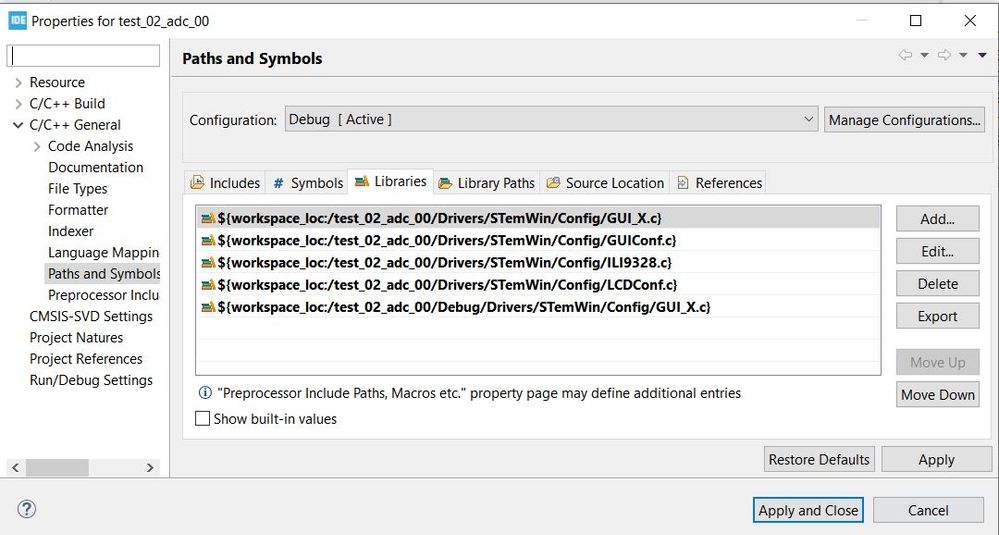

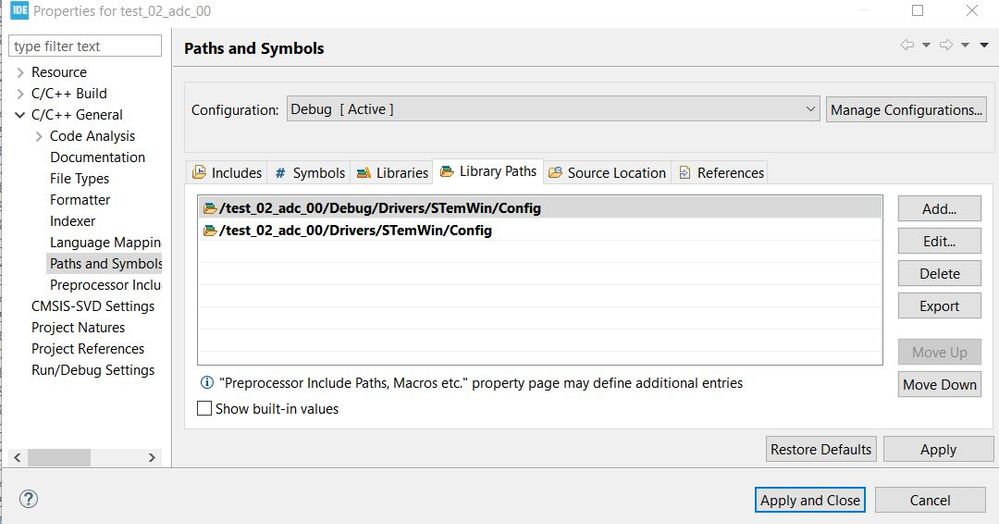

13:25:55 Build Failed. 1 errors, 0 warnings. (took 2s.90ms)In the Propieties-> Path and Symbols I was try to configure but not work.

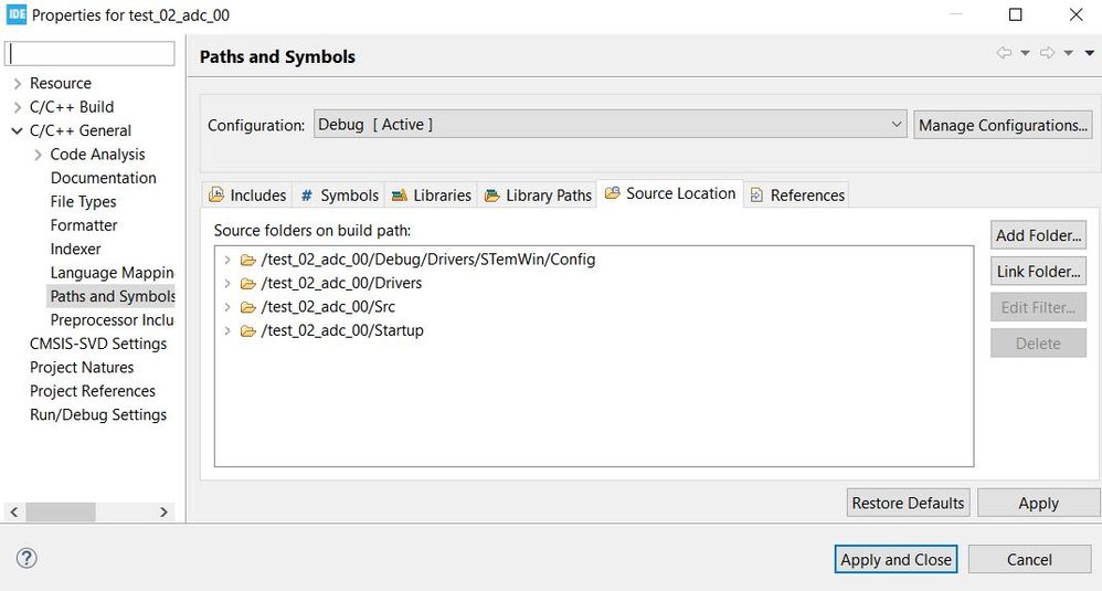

Those files are not libraries, they are source files. You'll need to mark the directory as a source directory, or similar, so they are compiled along with everything else. Alternatively, move them into your source directory.

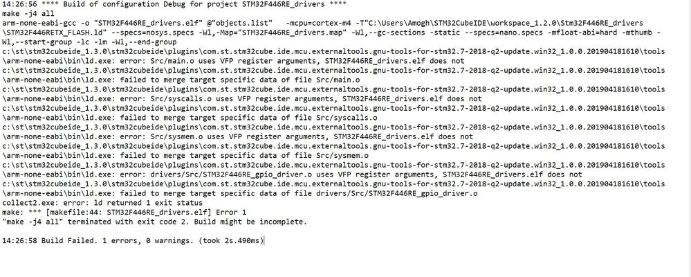

Attached screenshot of my error logs.

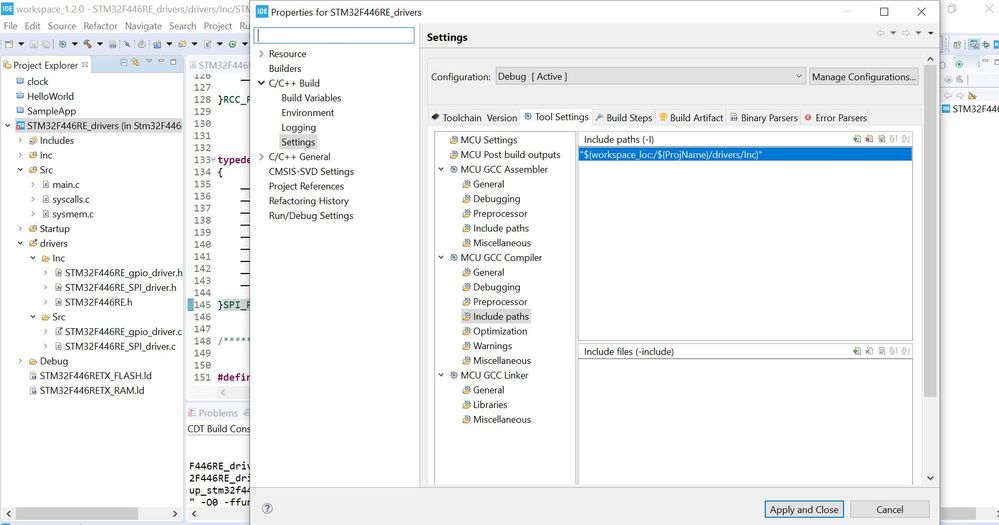

The path has already been added. Attached the screenshot below
