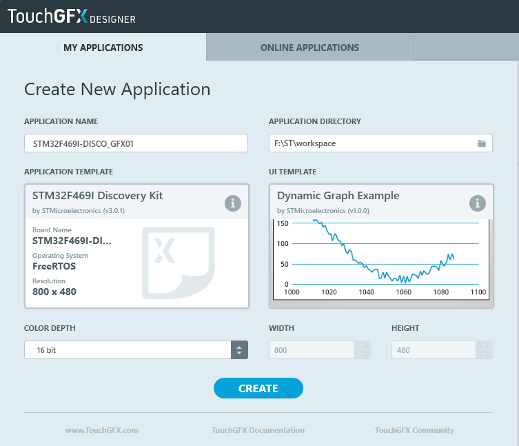

If I understand correctly your issue is a compiling error right ?
You also confirm that you started with the F469-DISCO Application Template available in TouchGFX Designer ?
In any case, I recommend you to recreate a project from TouchGFX Designer using the F469-DISCO Application Template.
Then, import your UI into your project. To do so, simply go to Edit->Import GUI and select the .touchgfx file of your UI project.
Generate code.
Now open CubeMX (NOT CubeIDE) and configure your settings nice and easy. Generate code. Regenerate code from TouchGFX Designer. Add your custom code using any editor (personally I'm very fond of Visual Studio Code) or even CubeIDE.
Then if not already done, open CubeIDE and double click on your .project file. This will automatically import the project into CubeIDE. Build and see the results ;)

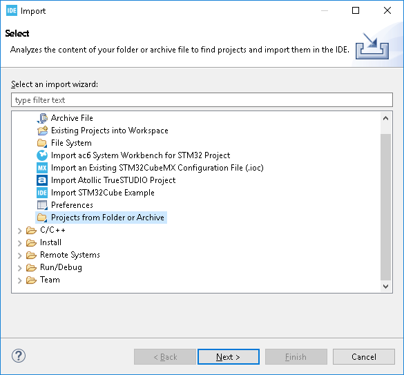

Alexandre, Thank you for this assistance you are giving me. I have uninstalled the version of STMCUBEMX, downloaded the latest version (6.1.0) and installed it as Administrator. I recreated a project using the STM32F46i-disco template, accepted the default settings and entered the unique pin configurations for my project. No matter what I do, the “Import Project�? menu item is grayed out. I have the latest version of TouchGFX loaded in the software packs and have uninstalled the older versions (4.13 and 4.14). I am making progress on my GUI application but at a loss as to why TouchGFX is not cooperating. I am running current Windows10 with 32GB of RAM with an i7 so the computer is not the issue. Is there possibly a registry setting that got messed up? Lance Doyle Electronics Design, Manf. Engineer Bruker Handheld LLC Bruker Nano, Inc. HMP Business Unit 415 N. Roosevelt Street Kennewick, WA 99336 USA Phone: +1-509-783-9850x6275 Fax: +1-509-735-9696 lance.doyle@bruker.com www.bruker.com/hmp<>
When you are talking about "Import project", what are you referring to ? I mean in TouchGFX you only have "Import UI". Are you talking about standalone CubeMX ? Maybe a picture could help understand better :)
