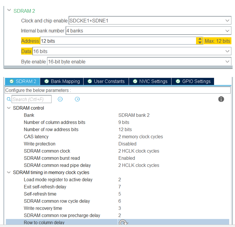

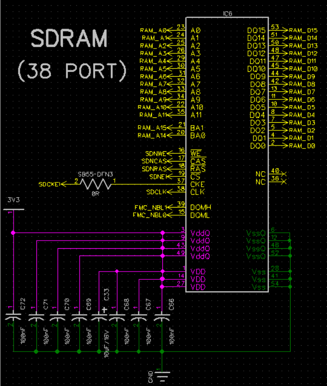

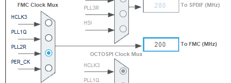

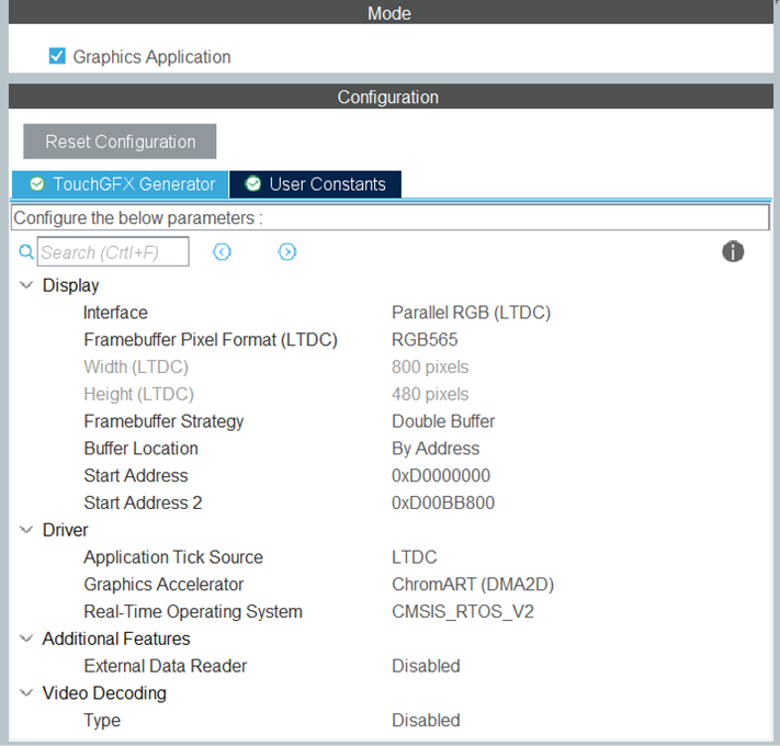

When activeted SDRAM, touch part dont work and screen is frezee
Freedom_Neo
Senior
I am using below development tools
MCU: STM32H7B3IIT6
IDE: STM32CubeIDE Version: 1.8.0
GUI: TouchGFX Version: 4.18.1
SDRAM: IS45S16800F-7CTLA1-TR
When activeted SDRAM, touch part dont work and screen is frezee, FMC settings are as follows.
0693W00000KZs5AQAT.png0693W00000KZs5yQAD.png0693W00000KZs6SQAT.png0693W00000KZs8dQAD.png
