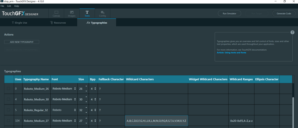

? means the characters are not generated by touchgfx. You need to put in any wildcard characters you want generated (so you dont have all glyphs from all your fonts creating a huge application).
2020-12-10 7:05 AM
I have included in wildcard Characters. But still the problem exists
2020-12-10 1:36 PM
Check your generated files in generated/fonts source files - Are the unicodes there?
Did you make sure to invalidate the textarea after updating its wildcard buffer?
2020-12-10 9:36 PM
Problem Solved I understand. How it works....Thanks a ton sir!
