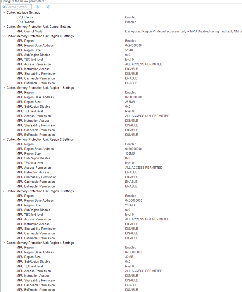

Hi Nicolas,
Thanks for your reply. This is my MPU configuration.
This is my memory definition.

2021-03-11 1:04 PM
Hi, I had this issue and I solved it by reducing the LCD-TFT clock rate. In my case (using an F769I-Disco) I changed it from 41.7MHz to 32MHz. If your UI slows down, make sure your optimizations are turned on. Good luck.
(As a matter of fact, the 41.7MHz came from the 3.0.0 F769 application template, and 32MHz came from the 3.0.2 template)
