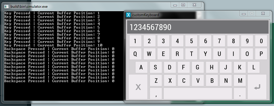

I am creating a custom keyboard following the example provided.
The code in the example is simple to understand and follow.
However, in my custom keyboard the following function behave weirdly
getBufferPosition()I have 2 callback areas in my keyboard, one for backspace, and the other for 'Enter' functionality.
When I call the function from the key pressed callback the function return the correct value.
However, when I call the same function from the backspace callback it always returns 0.
What is going on in here ?
please see the attached screenshots.
2019-08-15 12:19 AM
The function behaves in a similar manner when called from the Enter callback. It seems like the callbackAreas' callbacks not reaching the class of keyboard or something and getting 0 always?

2019-08-15 1:03 AM
Sure, here is my CustomKeyboard.cpp file
#include <gui/common/CustomKeyboard.hpp>
CustomKeyboard::CustomKeyboard() : keyboard(),
backspacePressed(this, &CustomKeyboard::backspacePressedHandler),
enterPressed(this, &CustomKeyboard::enterPressedHandler),
keyPressed(this, &CustomKeyboard::keyPressedhandler)
//Set the callbacks for the callback areas of the keyboard and set its layout.
layout.callbackAreaArray[0].callback = &backspacePressed;
layout.callbackAreaArray[1].callback = &enterPressed;
keyboard.setLayout(&layout);
keyboard.setKeyListener(keyPressed);
keyboard.setPosition(0, 0, 480, 272);
keyboard.setTextIndentation();
//Allocate the buffer associated with keyboard.
memset(buffer, 0, sizeof(buffer));
keyboard.setBuffer(buffer, BUFFER_SIZE);
keyboard.setKeymappingList(&keyMappingList);
add(keyboard);
void CustomKeyboard::backspacePressedHandler()
int pos = keyboard.getBufferPosition();
if (pos > 0)
//Delete the previous entry in the buffer and decrement the position.
buffer[pos - 1] = 0;
keyboard.setBufferPosition(pos - 1);
touchgfx_printf("Backspace Pressed | Current Buffer Position: %d\n", keyboard.getBufferPosition());
void CustomKeyboard::enterPressedHandler()
touchgfx_printf("Enter Pressed | Current Buffer Position: %d\n", keyboard.getBufferPosition());
void CustomKeyboard::keyPressedhandler(Unicode::UnicodeChar keyChar)
if (keyChar)
touchgfx_printf("Key Pressed | Current Buffer Position: %d\n", keyboard.getBufferPosition());
void CustomKeyboard::setTouchable(bool touch)
Container::setTouchable(touch);
keyboard.setTouchable(touch);
}The project is attached as well
