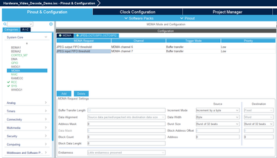

Hello @ABURM ,
I tried to replicate the issue using your project settings, and I pretty sure I found out where the issue is.

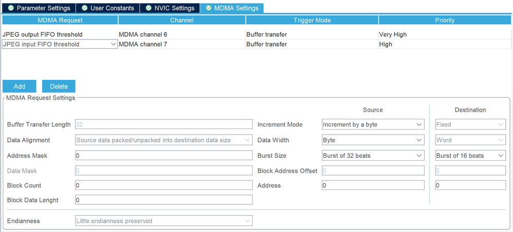

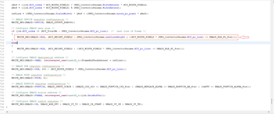

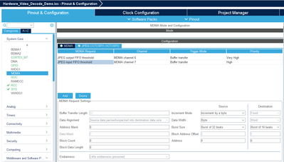

Could you please change the priority of JPEG input and JPEG output similar to the picture below?
I think you also need to change the Burst Size of JPEG input as well. (similar to the picture)
JPEG settings in MDMA

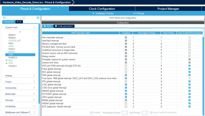

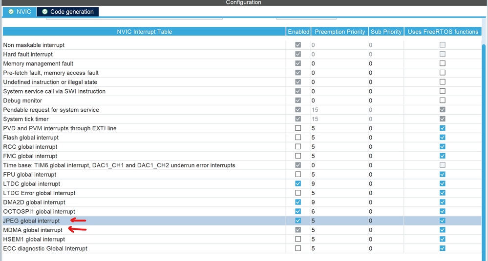

Also, ensure that the JPEG and MDMA interrupts are enabled with correct priority, like this:
Please try these settings and let me know about the results.

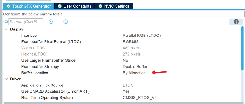

First, set Buffer Location in the TouchGFX configuration to 'By Allocation':
Buffer Location configuration
