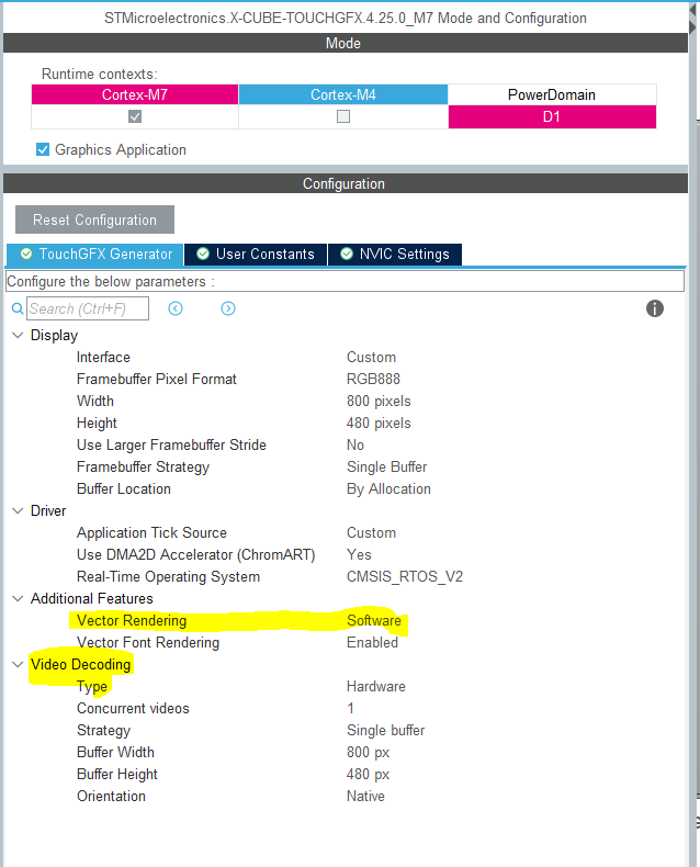

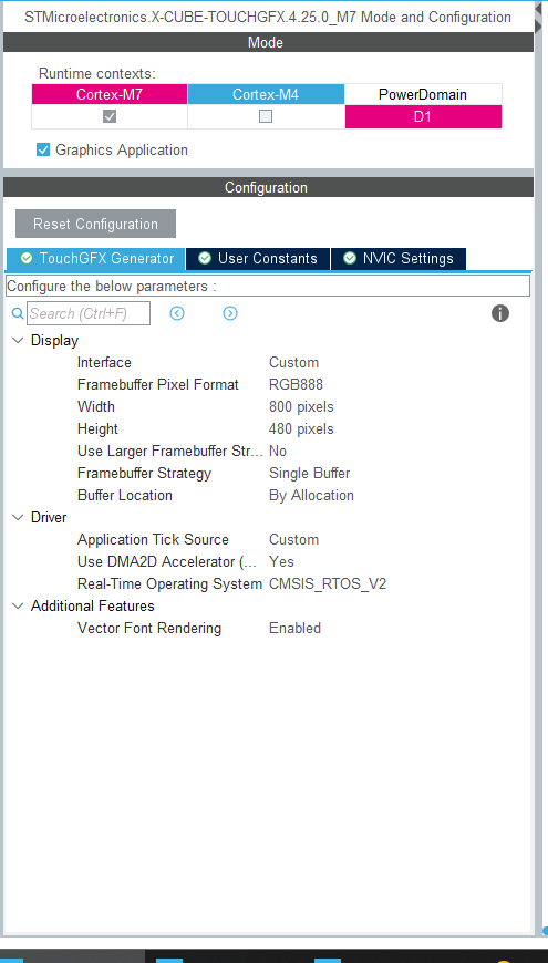

Im trying to configure TouchGFX manually on STM32H747I-Discovery board. Im using CubeMX version 6.14.0, after selecting TouchGFX for Cortex-M7 'Vector Rendering' & 'Video Decoding' options are not getting visible.
TouchGFX Manual Configurationbut on other hand if im generating project through TouchGFX Designer and checking ioc file then these options are visible there.
TouchGFX Designer generated Configuration
i compared both project's ioc files i didnt get any diffrence.. is there any hidden setting do i have to enable for this isse?

Hello @jumman_JHINGA,
First, please do not mention members when you ask a question.
I tried on my side and I dont have this issue with a project made from scratch in CubeMx, also follow this tutorial 8. Hardware acceleration | TouchGFX Documentation to configure dma2D (for video hardware decoding).
