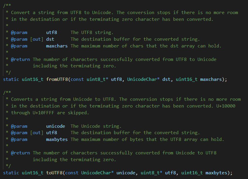

Hello BBlad.1,
You are right, characters in a string in TouchGFX are considered as Unicode characters as 16-bit unsigned integers.
If you want to convert to UTF-8, you can call the functions fromUTF8() or toUTF8() that you can find in Unicode.hpp.
/Alexandre
