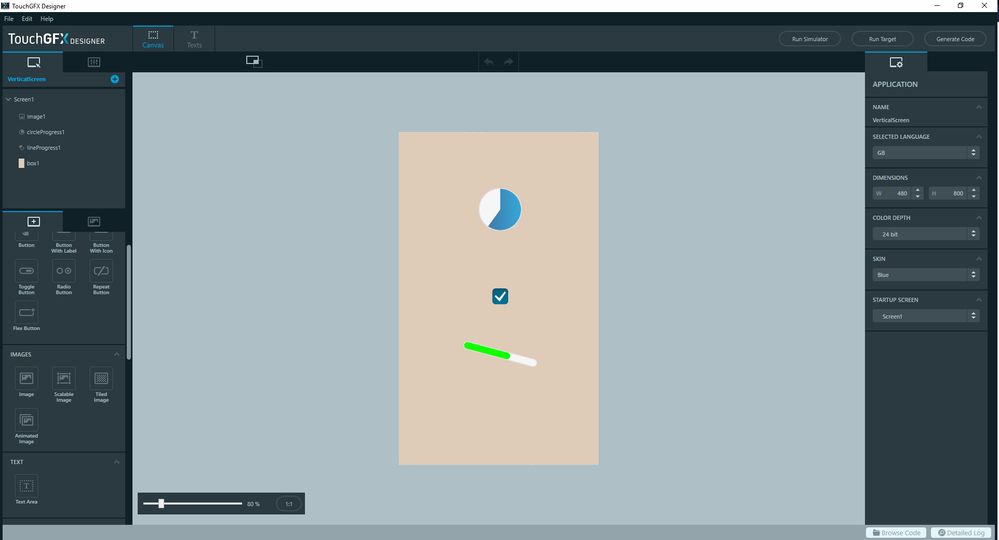

I'm gonna explain everything a bit better. So, what I want to do is to use the screen of the STM32F769I board in landscape mode. I created a default project with the template of that board in TouchGFX studio and then, I changed the dimensions of the screen so that it's now 480*800 and I dragged and dropped some widgets inside. It now looks as such:

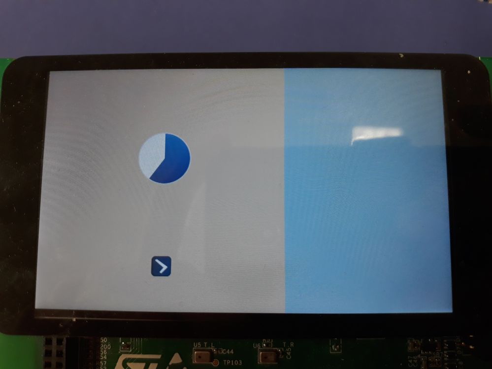

Now, I want to draw this exact screen on the 'real screen' but I'm unable to do so. I did what @qqAnton suggested (that is, add HAL::getInstance()->setDisplayOrientation(ORIENTATION_LANDSCAPE) in the function void GRAPHICS_MainTask(void) of the file BoardConfiguration.cpp and to change screen_orientation := -rotate90) and here's what I'm getting:
(The blue strip is from a previous screen). So it's clear that I'm not doing something right.
Thanks in advance for your help!
2019-08-26 5:55 AM
I'm confused. You said you want to display a landscape application. This is default. And now you've changed your canvas to be portrait (480x800).To me, the application looks as it should in landscape, but i'm pretty sure this is not what you want.
You want
HAL::getInstance()->setDisplayOrientation(ORIENTATION_PORTRAIT);
