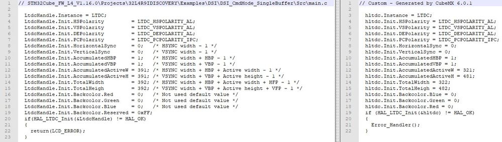

2020-11-04 12:41 PM
According to the ST documentation (DSIHOST presentation and AN4860) using LTDC with DSI in Adapted Command Mode is the most efficient way to control a display with internal GRAM. That's exactly what I'm trying to do. I believe HSYNC and VSYNC are solely related to Video mode which wouldn't apply.
I assumed since the window for the second layer was 0,0,0,0 it wouldn't have any impact. I test this by commenting out those sections of the function but there was no change in functionality.
I am familiar with partial frame buffers as well as the merits of different pixel formats which I can consider once I have the display functional.

Try compare your code with any TouchGFX demo for 469DISCO , this have DSI with Adapted with TE, but i mean DSI in Adapted mode too need sync pulses from LTDC.
2020-11-05 8:38 PM
I did compare with the DSI example project and it appears that the code generated by CubeMX for the LTDC configuration is consistent as the example shows 0 for the HSYNC and VSYNC values.
2020-11-06 12:25 PM
You show CubeFW example, but i speak about Touchgfx generated examples, this show part from my 4.15 when i select 469DISCO as target,
for your display is this better example as when i generate same way over TouchGFX without cube example for L4R9, where you have right sync is 0 for 390x390 display but MX_DSIHOST_DSI_Init have big diference for this two displays examples. Too 4R9 uses GFXMMU ...

2020-11-07 8:14 AM
The only significant differences I see are the changes introduced by setting VSYNC and HSYNC to 1.
hltdc.Init.HorizontalSync = 1;
hltdc.Init.VerticalSync = 1;
hltdc.Init.AccumulatedHBP = 2;
hltdc.Init.AccumulatedVBP = 2;
hltdc.Init.AccumulatedActiveW = 202;
hltdc.Init.AccumulatedActiveH = 482;
hltdc.Init.TotalWidth = 203;
hltdc.Init.TotalHeigh = 483;Using the same logic, I modified my code but observed no difference in the output.
