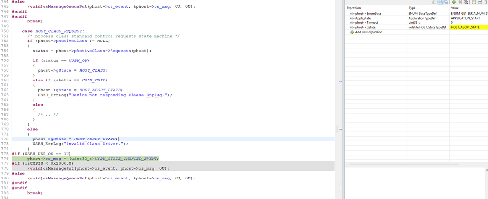

2025-02-10 5:13 AM - edited 2025-02-10 6:05 AM
Thank you for your suggestions.
- It gets stuck when entering USBH_Process. After receiving Appli_state: APPLICATION_START and phost->gStat: HOST_CLASS_REQUEST, the status remains at USBH_BUSY in usb_core.c, and phost->gState is set to HOST_ABORT_STATE.

2025-02-11 2:07 AM
Hello @walidhmz ,
It looks like you get to phost->gstate = HOST_ABORT_STATE because phost->pActiveClass is NULL.
It also looks like there is a specific log systems for the USB part, have you looked at it?
Perhaps it is because phost is not initialized correctly.
One solution to start debugging could be to look at the working project (without TouchGFX) and see where pActiveClass is set and then see if you do the same thing in the project with both USB and TouchGFX.
