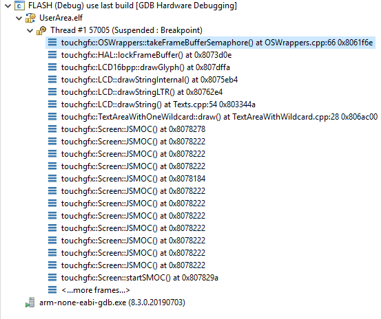

When switching between screens fast, my UI always ends up freezing. Debugging reveals that it waits forever, waiting for the frame buffer semaphore.
Here is the call stack:
Inspecting other running tasks shows nothing wrong. Only the graphics task should touch the frame buffer semaphore, right? So it should never deadlock?

2) I added the counters in lock/unlock functions. I was able to reproduce the issue again. Here is log :
I had programmed to break when the lock counters are 2 more than unlock counters. But unfortunately it did not break there.
This trace is when the function takeFrameBufferSemaphore waits forever.
3) I am pretty sure that we have updated all the widget files while upgrading the touchgfx. I also now cross-verified the files and they are indeed the latest one's.
I am testing the device further and hopefully we get a break in lock counters section. I will inform here as soon I have any update.

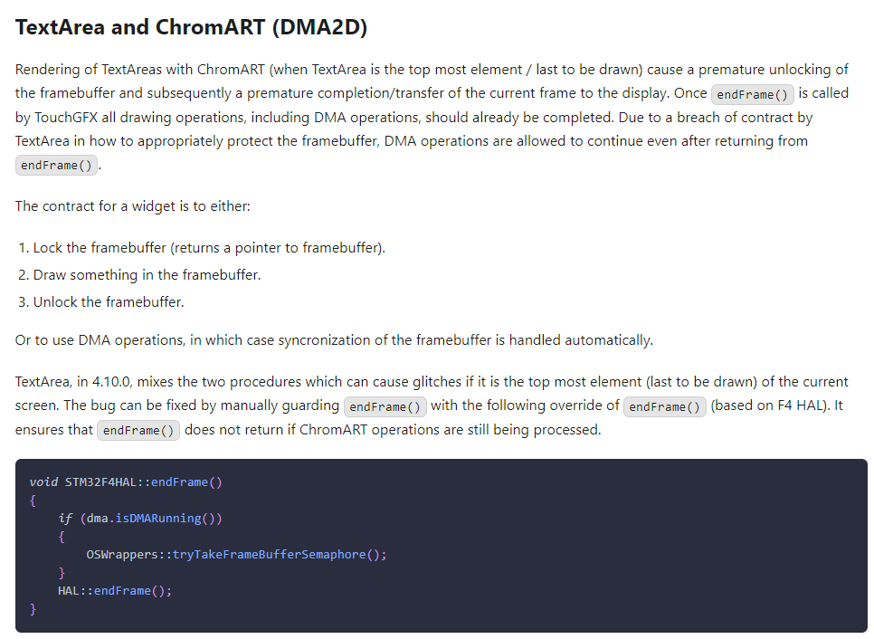

1) I compared my OSWrappers.cpp with the generated one. Most part of the file is similar. The only major difference I see is that the HAL::getInstance()->backPorchExited(); being called in function void OSWrappers::waitForVSync() in generated file. I am not calling invoking backPorchExited() in my OSWrappers. Does this have any effect on this issue ?
2) I saw this particular fix in known issues section of touchgfx https://support.touchgfx.com/docs/miscellaneous/known-issues#textarea-and-chromart-dma2d
At the moment I do not have this change in my source code. Does this have any effect on this issue ?
3) I am thinking of creating a global uint64 variable and set every bit at the start of widget draw function and reset it at the end of draw. By doing this, we may find out which widget draw is trying to lock the buffer and not unlocking it. Does this technique help in finding the problem ?
Can you please help in clarifying ?
