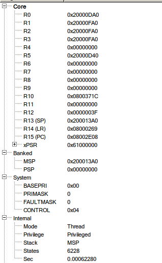

2019-04-15 1:14 AM
Hello ,
thank you for your reply,
In the debug screen I have the following registers shown.
I am using Keil

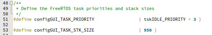

2019-04-15 1:21 AM
Also I am not changing the configuration of GUI Task , I am using templates provided in TouchGFX designer ,,
2019-04-15 1:52 AM
No, the SCB registers, like here:
