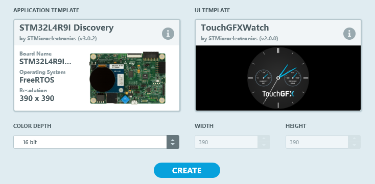

0693W00000DmvtzQAB.pngThank you very much for your answer. I tested it. When I used the above example on the STM32L4R9I-disco, it was normal when I didn't add my simple thread. When I added it, it sometimes crashed.When I added a simple thread, I checked it, and the stack did not overflow. The simple thread was running normally, but the Show crashed. My simple thread is as follows
unsigned int test_val;
 for(;;)
test_val++;
if(test_val >= 1000)
test_val = 0;
   osDelay(1);
I will try to re-port it completely, hoping to find the problem.
