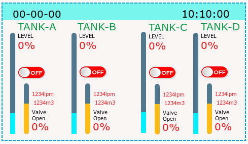

TRying unuccessfuly to copy/paste Screen1 to a new project
ksale.1
Senior II
The screen has 4 containers and many widgets. I am interested in keeping the names during the export to save lot of repertitive workscreen.png

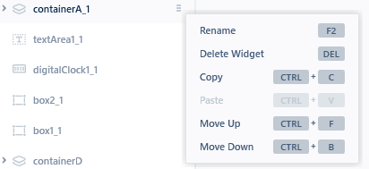

Please note "Right-click completely broken, no context menu"
Please note no 'Export' in the context menu v 4.26.0
