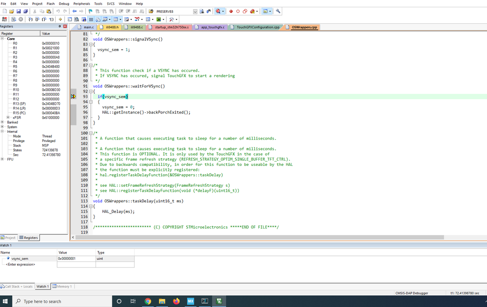

I have made this very simple project, when I step into code and just change the vsync_sem in debuge to 1 to force a render, The code would just call this function
HAL::getInstance()->backPorchExited();
and never would retrun, it would stuck in there, How should I resolve this issue?
I expect the this force a call of this function
void TouchGFXHAL::flushFrameBuffer(const touchgfx::Rect& rect)

A simple test, I just hand edited this function, to false
lockDMAToFrontPorch(false);
Now it would render! am I missing something?

lockDMAToFrontPorch() when set to true, means that the DMA will not fill the framebuffer before the whole frame is sent to the display. This prevents corruption of the framebuffer when the DMA is quicker than the sending of the frame. Of course this reduce performance but it usually prevents from seeing artifacts. If it was stuck when lockDMAToFrontPorch(true), this can mean that the framework was waiting for the previous frame to be sent before rendering again with DMA2D.
