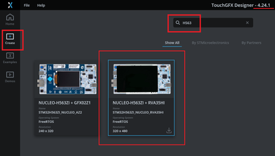

2024-11-11 12:30 AM
I think V4.21.1 doesn't support that board.
Try the latest version V4.24.1:
Hope that answers your question.

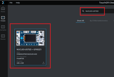

2024-11-12 7:23 AM - edited 2024-11-14 2:23 AM
@BFlin.1 wrote:
This is shoeing for H563ZI with RTOS, I am looking for U575ZI-Q and without RTOS.
Sorry the story of RTOS was not indicated in your original post and you asked also for NUCLEO-H563ZI: "There is mention of "TouchGFX Demo Projects: Includes demo projects for the ST Development Boards: NUCLEO-H563ZI & NUCLEO-U575ZI-Q, helping you get started quickly"
And this is for NUCLEO-U575:
And I don't think there will be a demo without RTOS. All the demos available are with RTOS.
