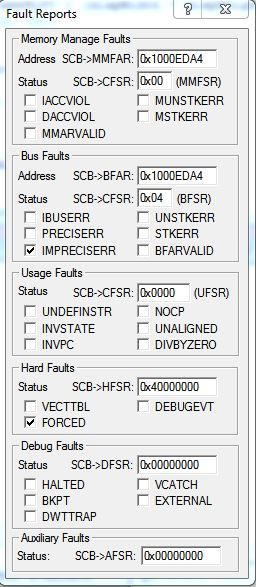

2019-09-09 4:04 AM
Hey @Martin KJELDSEN
I'm back once again with few more test and updates and problems as well =)
As per your suggestions and touch GFX guide for the custom board, I have made few changes in my code
(1) Implemented 60 Hz timer for the signalVSync() (which is working great)
(2) Added and link my custom "generated" and GUI files with the code
(3) Un-comment "#define SINGLE_FRAME_BUFFER_INTERNAL" for the internal flash and SRAM use (which causes problem!)
with the 3rd change, I'm getting Hard fault

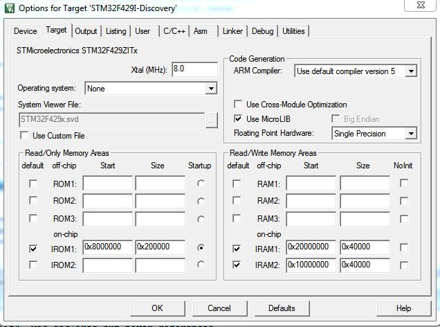

My, target MCU is STM32F429ZI having 2MB flash and 256+4KB SRAM
I'm using keil MDK 5 for as IDE
Here is the memory footprint after compilation code on keil5
Code = 57840 bytes
RO-data= 565412 bytes
RW-data= 2500 bytes
ZI-data=215644
RW-data=2500
For "Option for Target", i have attached in screen shot
Stack_Size EQU 0x5000
Heap_Size EQU 0x200
FreeRTOS task heap size 2000kb
From the memory footprint, i can say that it should be easily fitted with my MCU, but unfortunately that's not happening!
The functions at where I'm getting hard-fault is shown here
Bitmap::registerBitmapDatabase(BitmapDatabase::getInstance(),
BitmapDatabase::getInstanceSize(),
bitmapCache,
bitmapCacheSize,
numberOfDynamicBitmaps);
/* Calling from Above BitmapDatabse Function */
namespace BitmapDatabase
const touchgfx::Bitmap::BitmapData* getInstance()
return bitmap_database; <--------------Cause Hardfault
uint16_t getInstanceSize()
return (uint16_t)(sizeof(bitmap_database) / sizeof(touchgfx::Bitmap::BitmapData));
}@Martin KJELDSEN Can you give me any suggestions ?
Here is the hardfault report
Eagerly waiting for your feedback
Regards
Mahendra Sondagar
