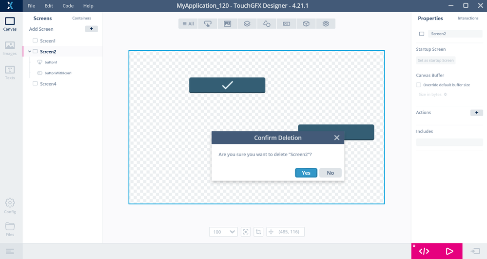

Another suggestion to attention is that you add a screen and work on it for a while If you ganna delete an icon or widget and if wrongly a screen is selected instead of them you will lose the screen and there isn't any undo shortcut key to return deleted screen. also, touchGFX doesn't show a prompt when the delete action happens. it leads to losing everything easily.
thank you for your attention
2023-01-25 1:46 AM
Hello MTora.1,
The deletion of a screen with no widgets in it will indeed not show any message, but if you try to delete a screen with some widget, you'll have a "Confirm Deletion" popup as shown bellow.
So you could never delete a entire screen by mistake ;)
/Osman

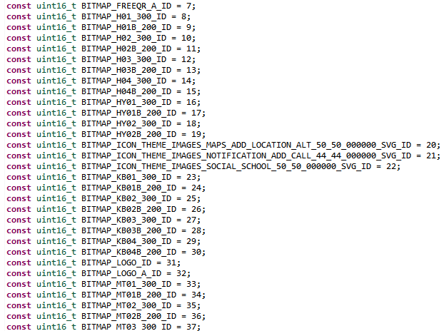

Hi dears
I'm going to add something to the image group feature.
as you see in the image attached below, The touchGFX software sorted added images by alphabet order.
then give them an ID and integer number. It would be great if you be able to change the sorted list manually, So users can work a group of images in a sequence or loop simply in code.
for example, the user can work on the first image with ID and the corresponding number of BITMAP_image1_ID=30.
So you easily increase the number to 31 until the last image.
