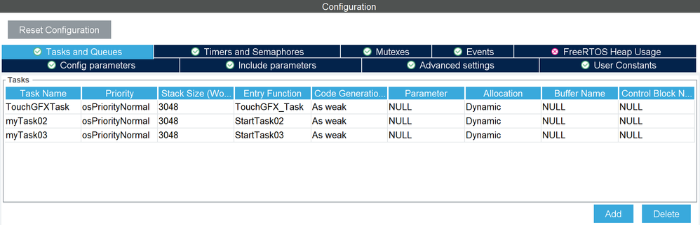

2023-03-28 1:28 AM
Hi, Thanks for the reply.
The TouchGFX_TASK is already defined there, so I added two more
With this setup StartTask02() is called, the other two are not called!
The changes made are basically what I was doing manually but with a different outcome!
