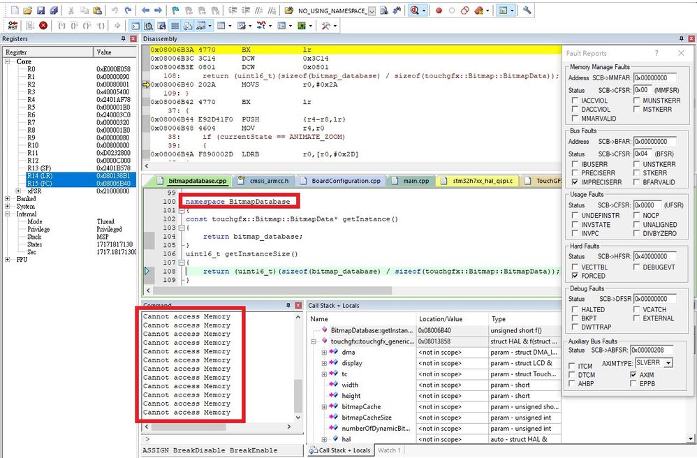

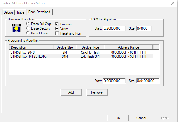

I try to use MDK-ARM Keil to debug TouchGFX project?
But it hang on Debug mode.
When enter debug it directly run and hang like photo below
This happen after I add new algorithm for STM32H7

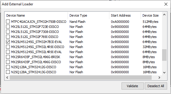

After adding this for QSPI setting for insufficient flash
Because I code and photo are more than 2MBs so I need add .flm file to use QSPI
Here is my file
Thanks

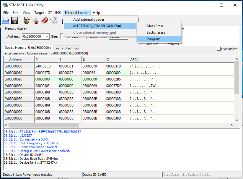

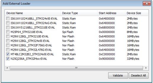

2019-05-16 5:53 AM
I use stlink to connect my keil.
You mean ST-Link Utility like photo show? I try it later.
2019-05-16 6:04 AM
Yes i mean the ST-Link Utility, sorry.

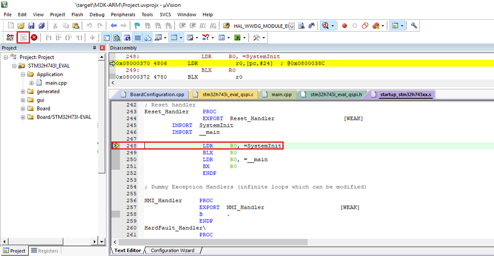

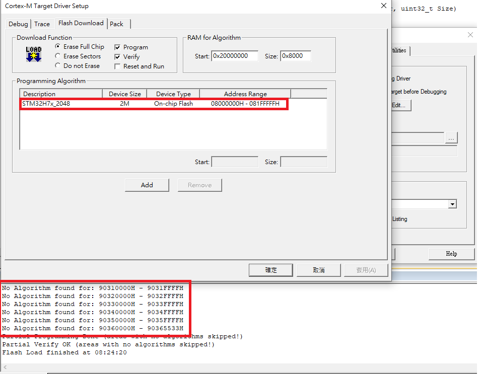

2019-05-16 5:52 PM
Hi Martin
I tried but I still have problem
Keil still need download external flash
If just download STM32H7X_2048 it will have error like photo below.

2019-05-19 11:43 PM
If you just remove the external flashloader configuration from your Keil project, enable the project to convert the axf to hex, then use ST-Link to program the entire range (even internal) - Just use "target->program" instead of "External Loader->Program".
/Martin

I already entered debug
I still have problems with QSPI
So far when I hang at BitmapsBase
I can't enter 0x90000000 where should I call QSPI read() function
to solve this issue?

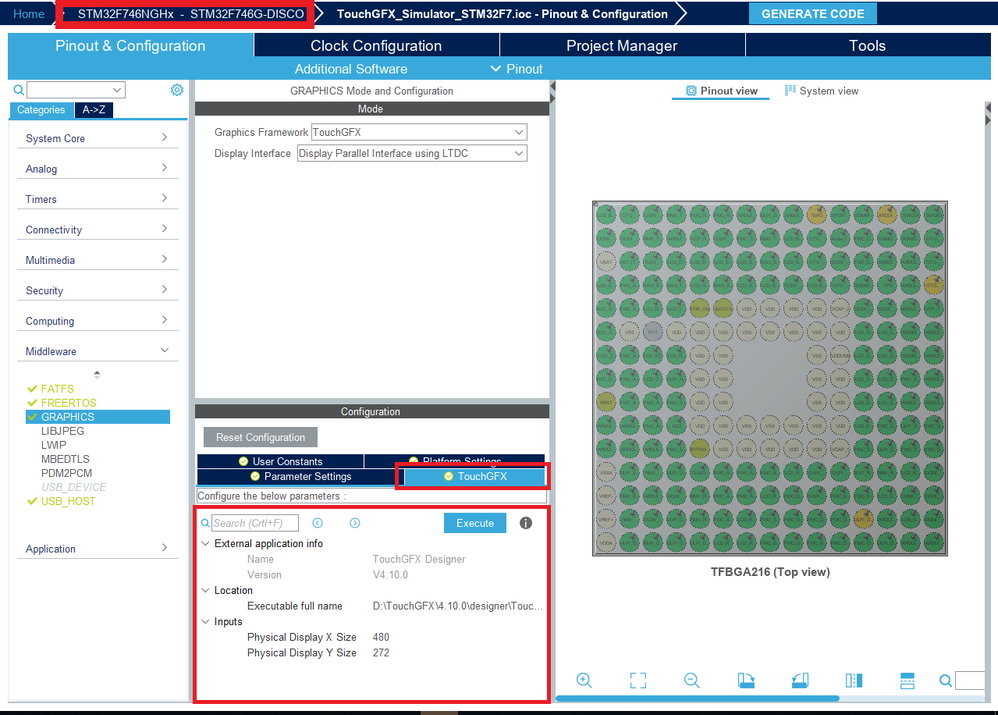

And one more question
Is here any future plan STM32CubeMX will update STM32H7 to support TouchGFX like stm32f7 series photo below?
2019-05-20 12:37 AM
There is no executable code in QSPI, only asset data.
I don't know about the current CubeMX roadmap re: H7. But the general goal is to have TouchGFX be enabled for all relevant MCUs.
