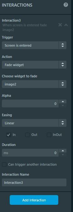

One more problem.
I have an image. How do I turn it into a button?
Andrzej
2020-10-21 1:01 PM
Hi @Andrzej Dębski ,
You can add Interactions to configure an action or when a trigger happens.
To add an interaction go to the INTERACTIONS tab in the upper right corner and click the blue button labeled "Add Interaction" to create a new Interaction, as shown in the image below.
Then, set the interaction that you want on the "Trigger" case and choose the action you need to effect on the Action case.
There is sevaral options to applied for an interaction and different actions can be there. Have a look at the Interactions section in the TouchGFX User manual, for more details.
Hope this helps you.
