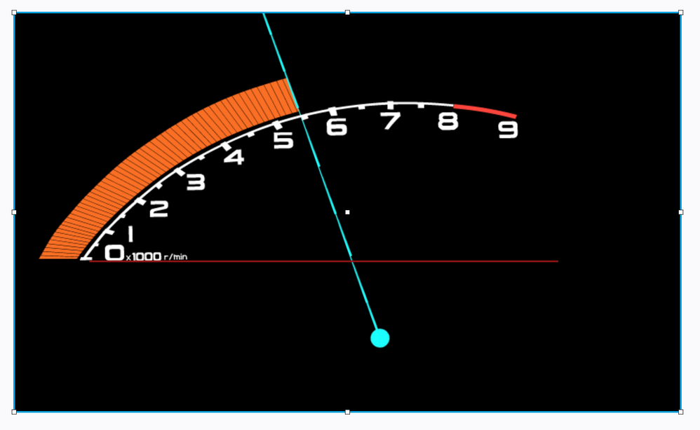

The issue I am having is about scaling an image inside of TouchGFX to match RPM.
See image below
I am trying to properly scale this image to match the RPM. 0 to 9000 rpms is the range but I cannot get the progress bar to match it. Can you help with this? See attached TouchGFX Project
What do you mean you try to scale the image to match RPM ? You try to make it bigger ? Smaller ? Directly in code ? What is the link with the rpm range ?
From the picture, to me the needle matches the progress bar. Can you elaborate ?

Hi Alexandre,
I am having trouble trying to get the image to match the Set Value. For example if I set the value to 1000rpms it does not match the number on the image. I tried different methods and cannot get the image and set value to match

Hello Gen-Tune,
I think the reason why it does not match the value is due to the shape of your rpm scale.
The Gauge widget available in the Designer describes a circle when the needle move from min to max value. In others words, every point is equidistant to one another.
In your case, the needle needs to cover different distances depending on where you are on your rpm scale.
What could be done, in my opinion, is to figure out the mathematical equation that describes the curve of your rpm scale and then copy/paste the Gauge widget (Gauge.cpp/hpp) in your gui/ folder and modify the Gauge::setValue() function to make the needle move accordingly.
