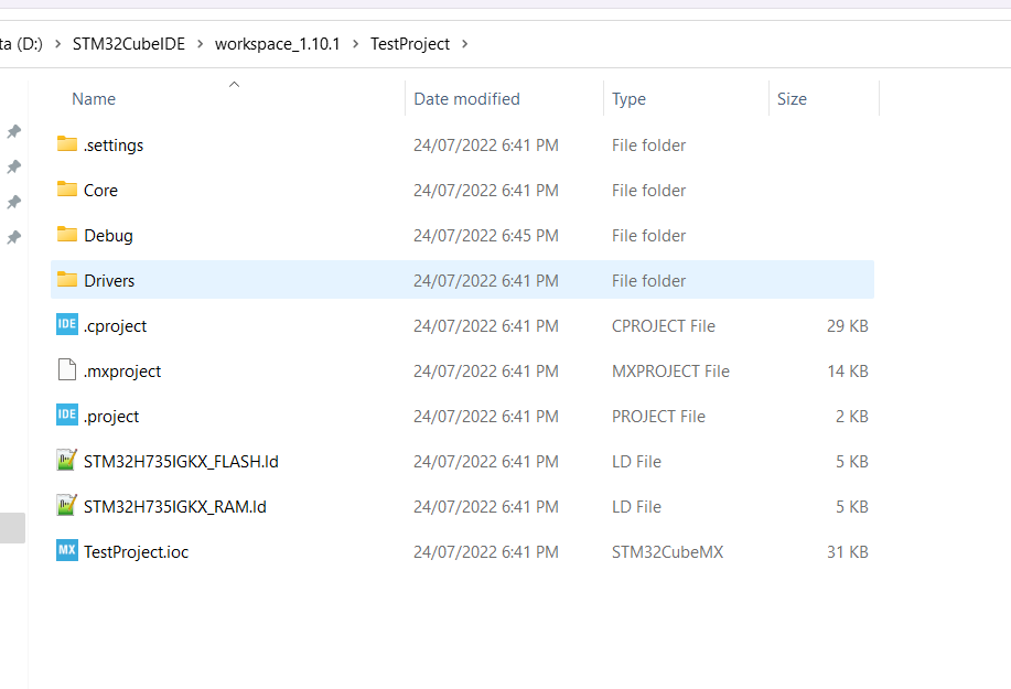

You mix apples with berry
Imported touchgfx project (ioc file) ioc is MX project file.
For projects created in TGFX (not all) search IDE folder in and .project file. No ioc or other...
If you use KEIL search ...
Normal way to create custom TGFX isnt from TGFX, but new project in IDE or MX.

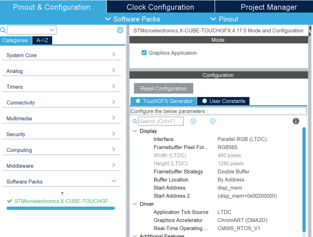

Yes you miss some steps.
Normal way is:
repeat 234 to working LCD
2022-07-25 12:57 AM
2022-07-25 4:17 AM
You skip Configure Software packand ...
2022-07-25 4:56 AM
OK, got it now.. thanks for your help :)
