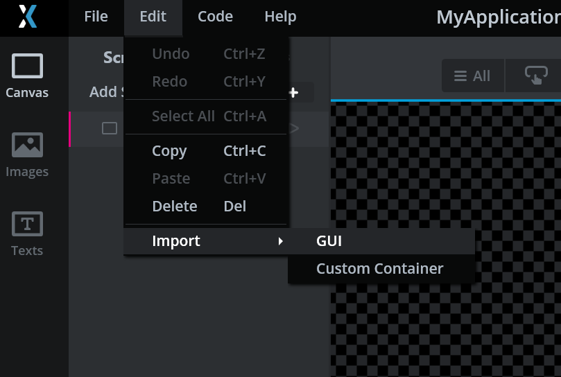

In TouchGFX Designer, we have a functionality to "import GUI" which will copy the GUI and all associated user code from an older project to your new one.
