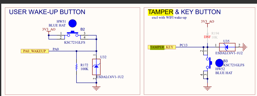

Check schematics if Wakeup button have own pull down/up. Change code SET/RESET ...

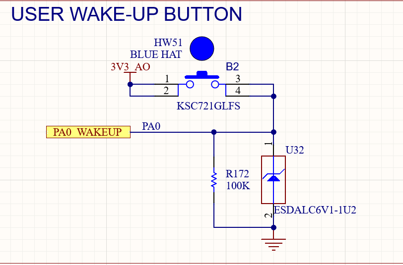

Hello MM,
The BSP uses no-pull, but this is the schematic of the Wake-up button. I attempted both no-pull and pulldown though, and the result is the same.

I try say you need check schematics if think dont work
as you can see Tamper is switched to zero and but to one.
Your sample code for tamper block code for button ...
