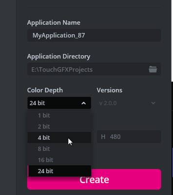

We do not provide monochrome examples because we do not have any monochrome display on the STM32 discovery boards or our partners displays.
However, you can create a project in TouchGFX Designer, select the Simulator (not a board) and before creating you can choose the bpp :
Here 4 bit is monochrome.
Then you can either create your own GUI or go into "Edit" => "Import" => "GUI" and select something simple like a text example.

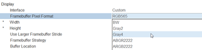

example, how to work with 128240D-FC-BW-3 ?? 32 gray scale monochromatic RS:146-1599. how to make button, picture? I need to do everyting myself with photoshop? how to organize project, not only resources??
2025-05-19 5:20 AM
Hello @Msolinas ,
I don't know what you mean by gray 32. You can select gray 4 in STM32CubeMX :
This way, your framebuffer will be in gray 4 format, you just have to make sure your display is set to gray 4.
If you have assets without color in your GUI, you can build your project and TouchGFX Image Generator will convert your image.
Otherwise you can create your own assets in the correct format.
