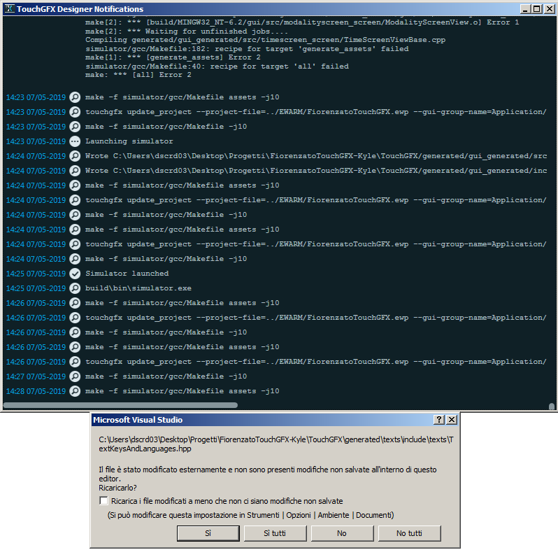

As title say, today my TOUCHGFX keep compling again and again even with no chenge in the code or the layout ( i literally took away my hands from keyboard, but he keeps compiling as u can see in the picture above)
I apology for the second part of the image being in Italian, but essentially it's visua studio saying that some file has been changed by someone(touchGFX i'd say) and needs to be reloaded, and this keep happening, when hefinish to compile... he compiles again, my pc is melting. Any clue/help/fix?

after 2 hours of restarting and preying it stopped compiling, i introduce some errors to force him stop compiling when i was ong my code, i figured out it was keep compiling only on compilable project, so introduce an error fix the problem (i mean my cpu was saved at least). now btw the problem seems solved, but i think it was some problem with the automatic bitMAP AND TEXT DATABASE, which were keep recreated (even if no modification occurred), and so all project was recompiled again and again.
