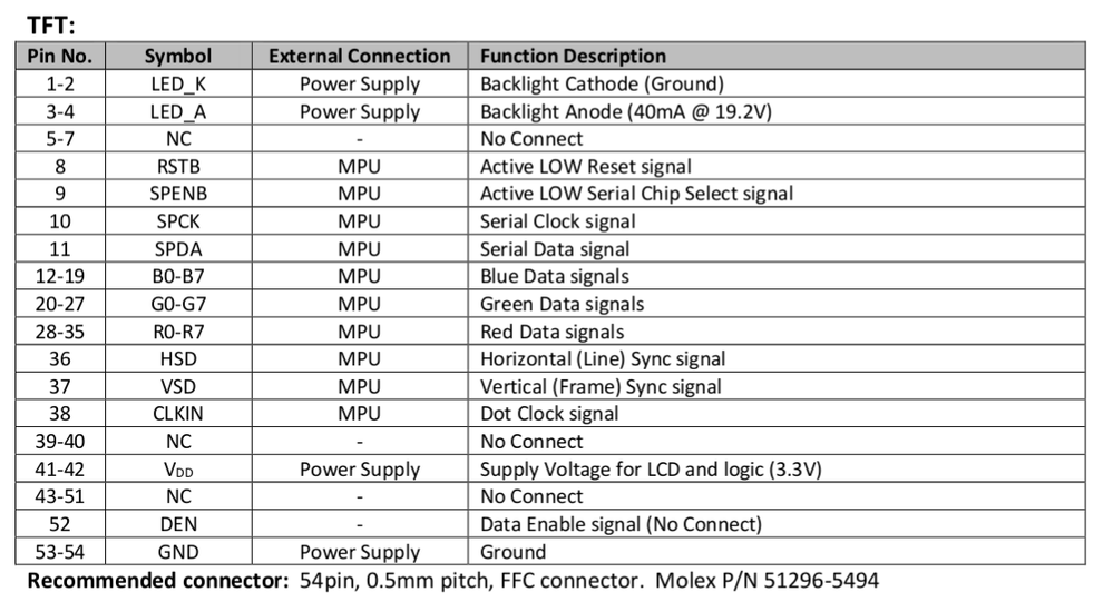

i have to move from dev board to final product still on STM32F429 but the 320x240 display has different controllers: NV3035C & FT5426
the link will still be RGB (maybe RGB666) with Hsync e Vsync (is clk needed too?) as per the LCD pinout here:
i failed to find hits on google. anyway i suppose it should work out. the general hints are clear:
