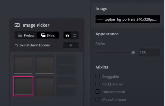

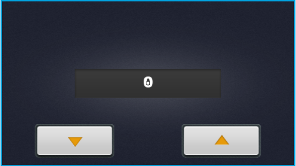

I was following the video in the link https://www.youtube.com/watch?v=vy1c1LbypuM on how to make the screen below, but the video uses version 4.18.0. I need to figure out how to make the background for the text using the current version.
In version 4.18, the procedure corresponding to the figure below was used. Is there an equivalent procedure in version 4.22.1?

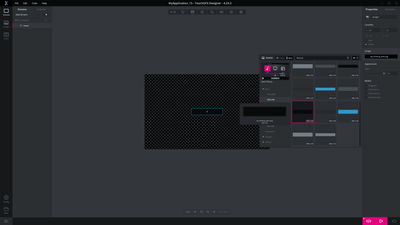

Hello @AMend.7 ,
Indeed there is an equivalent.
We replaced the "Skins" with the "TouchGFX stocks".
There is something similar.
You can add an image, then click on the image selection on the properties on the left., then click on stock, then "bars" and here I was able to find multiple long rectangles such as the one bellow.
