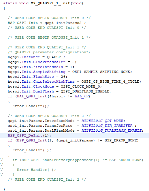

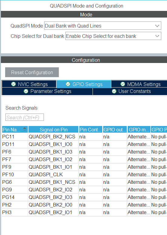

Thank you for your clear explanation. As you said, I removed the memory mapped mode part for qspi, but while doing this, I saw that there are 2 flash instances for this card. I wonder if this part is completely separate flash from touchgfx?

Check the stm32h750b-dk board schematic, Page 11, you will see U2 and U1, each chip over it's own bus.
So, the QSPI is in dual bank mode. The data are fetched 8bits at a time to double the speed. You shoud disable dual flash mode and than write/read using only one chip.
